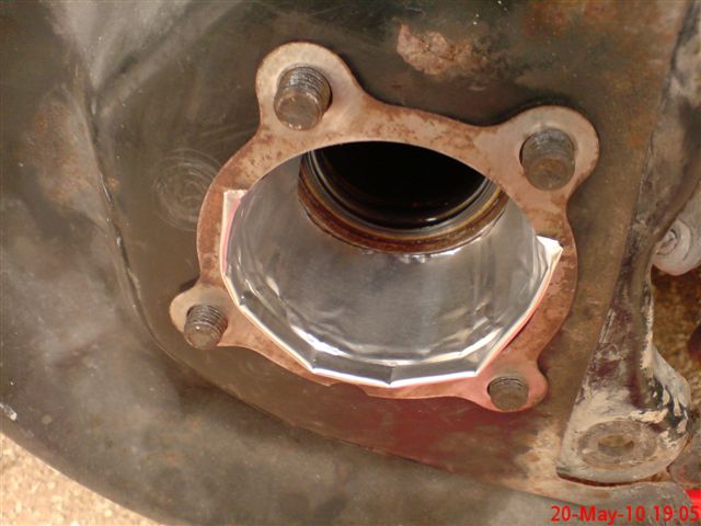

05-20-2010, 08:35 AM
Halfshaft moving in & out - strange problem
I will try to fix it somehow. I don't feel very comfortable with it.
I can:
1) Put liquid gasket
2) Add an extra ring cover inside the plate and prevent extra play
3) To hit inner surface of housing in several places and make it rough
Fun is not the straight line!
05-21-2010, 08:56 AM
max_ae86 Wrote:I will try to fix it somehow. I don't feel very comfortable with it.
I can:
At the end I simply cut a piece of thin alu-plate and put inside. It seems to be tight enough, I had to hit axle 20 times with a big hammer very hard to go back. I hope it will stay in place from now on. :wink:

of course there is a steel cap secured with 4 bolts keeping bearing and all its gaskets in place. But there is a gap of 2-3mm between plate and the bearing because the plate is bolted to the diff housing. I just don't like those 2-3 mm of axle free play so I fixed it.
