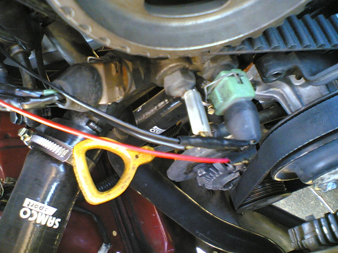

Ok, well out of the three connectors, the biggest one has no black cover and has four connections on it. I did make a typo (Banging head ), what I meant to say is that the cel does not flash. It still just stays on. Next, the harness I've got is really quite butchered in my opinion. And not like RHD to LHD butchered. To give you an idea, I had to move the connectors for the cold start time switch and the coolant temp sensor from the back of the motor to where they are on the front. That's like an extension of over a foot. Nothing should be that far off I would think. But according to your last comment, they are on the back of the head. Anyways, I've got the brown going to brown and green going to green, so that shouldn't be a problem.
EDIT: I took some pics of the connectors, and I'll post them in a bit. Also I'm on zenki ecu if that helps or anything.

Ok, wouldn't let me attach for some reason. I'll link them.
The connectors at the back of the motor
[Image: AEU86 AE86 - High impedance inj with MAP...edance ECU]
What I have listed as the diagnostic connector
smaller connector that had a black cap, don't know what it is
smallest connector, no clue
no clue what this is
brown and green connectors at the front of the engine after I moved them almost 18 inches

Well that's a first....never seen that on any hachi I've ever seen.
That is supposed to be situated in a housing that is attached to the head on the firewall side of things.. Looks like you have some sort of custom inlet housing. Can you get a clear picture of that thing?
The diagnosis connector you're after is the one with 2 terminals.

That inlet housing is the stock usdm housing. Nothing special. i'll take some pics of it for you later on. I'll try to jump the two wire connector today and see if that gets me anywhere.
