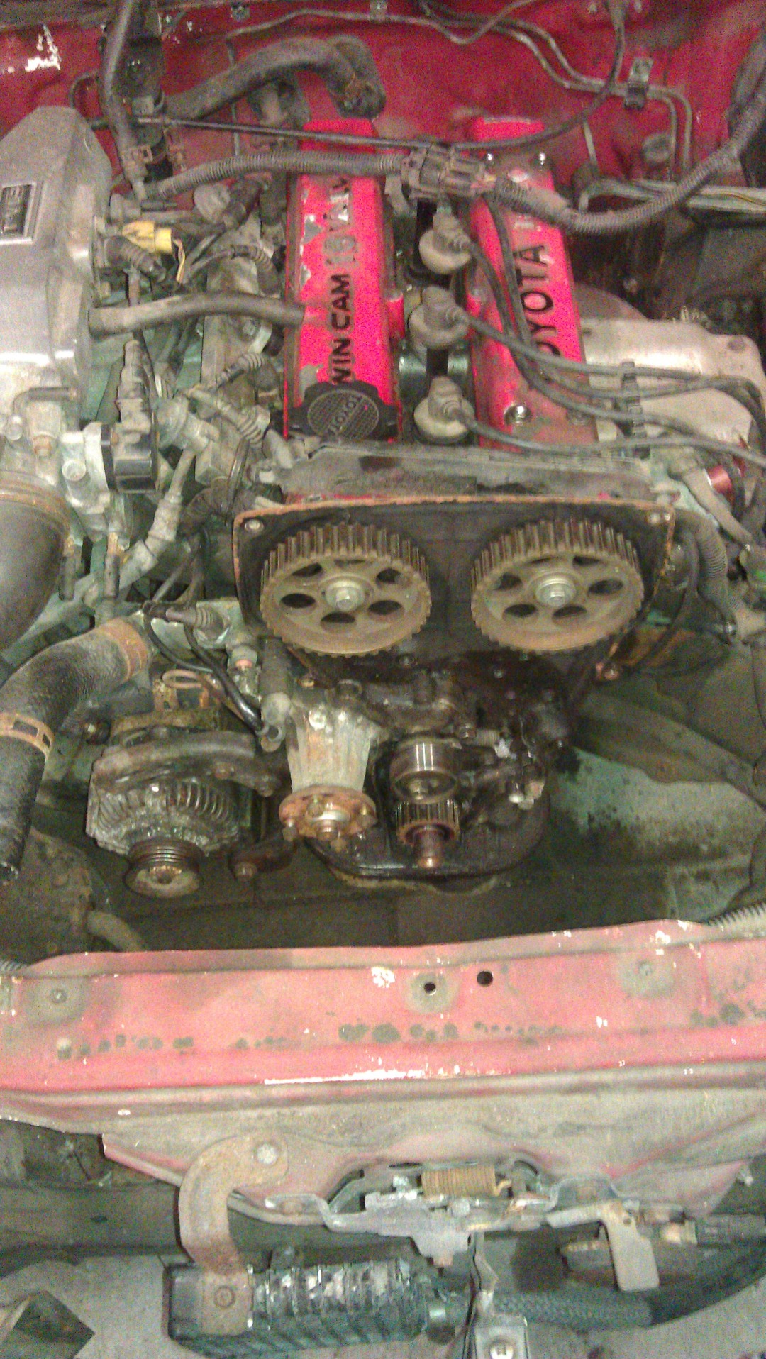

repaired the clutch today, the old one doesn't look very worn out, but the springs in de diaphragm aren't parralel anymore, the bearing was worn out.within the first few cm pressed on the clutch pedal you could release the clutch so i assumed the plate was worn out.the pedal feel is now much better.
changing the clutch is a breeze. the distribution belt that i received had a defect, the fibers were visible and 2 fibers were broken so i had to exchange it for a new one they had to order. ordered a new relais for the starter motor. when everything is back up and running i am gonna check my spare rear axle and repair it, and then exchange it with the one that is under the car now. Real men race downhill |
