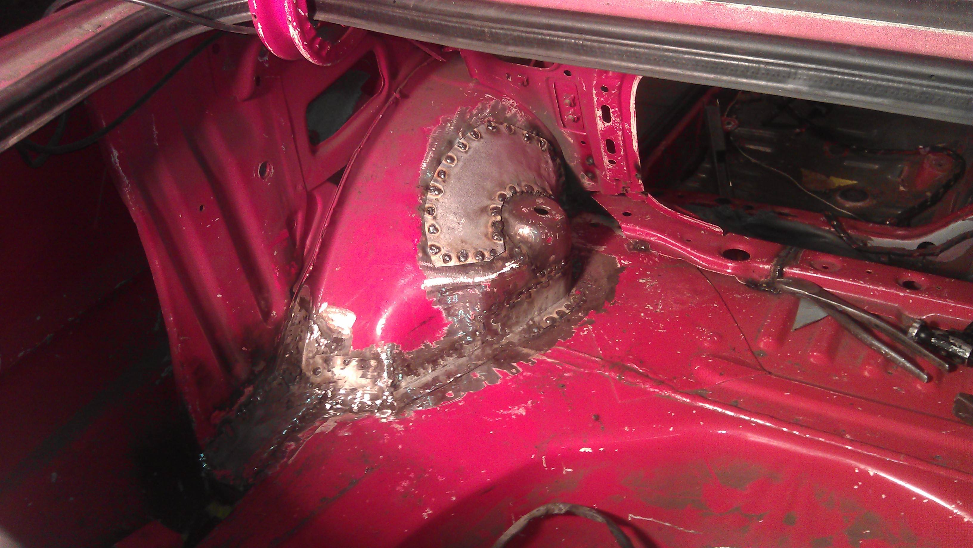

So step 1 is MOT for the red one, we replaced a lot of things before we took it to the mot.replaced all brake hoses,steering knuckles, steering rack rubbers,replaced the front rubbers with the prothane set,disassembled all the brake parts and cleaned them.replaced braking fluid ans repaired A LOT of rust.replaced the front fenders with xtr FRP ones,sealed of the leaky sunroof.
The car was checked for MOT friday, I have to weld the exhaust some more (its leaking) and the beams where the rear bumper bracket slides into is rotten to far (i knew this one was on the edge)all other things are ok.
