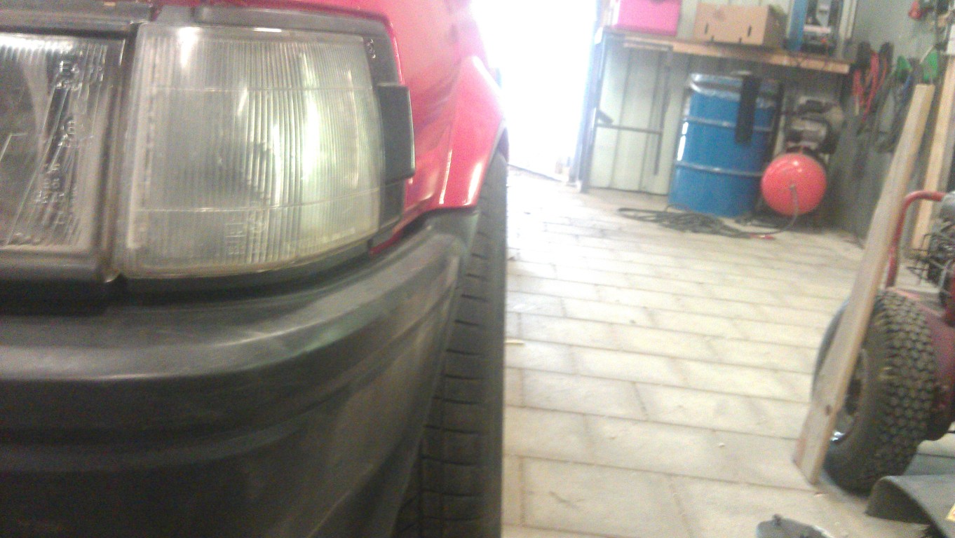

front fender braces are now mounted, ordered them from ultra racing.Fitted fairly easily, had to bend away some small parts of the chassis to make it fit.Mounting the bolts is a bit tricky since my hand couldn't fit inside the fender, but i pulled it off by clamping the nut on a welding wire and fiddle a bit.
Front struts are mounted in combination with the camber plates.The wheels that i have now are not a good fit, the tire rubs against the strut just a little bit.I also can't lower the car too much because the spring seat ring will touch the top of the tire. These struts probably need a really different offset wheel.The khamsin one are +18 and fitted nice with the standard struts.I tried the BBS rims which are +5 offset, it looks a lot better but still not ok. I checked online and people who use these struts run on et -20 So right now i shimmed out the wheel with rings just to check how much it should be spaced out to fit and a 20mm wheel adapter should do the trick.but since there is now not enough thread left to screw the bolts on i jacked up the suspension to check.I need to remove the plastic inner fender but looks like this is the way to go. Real men race downhill |
