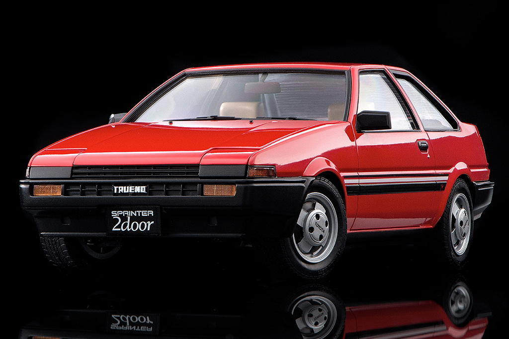

(09-28-2019 08:38 PM)banpei Wrote: Nice Celica XX! Sadly the MA60 was given to me because the kit has a few missing and broken components (the kit is ancient and has a 1981 copyright date on the box), so its unlikely I'll build the scooter or the driver. I also won't be motorizing it, but here's what those parts look like: I guess I'm updating both of these models now? Here's the Supra: Here's what I'm aiming for with the build: There's been plenty of work done to the Lime shell, but it doesn't show in photos so I won't bore anyone with it for now (its mostly been filling and sanding). Instead I'll explain the work done to the interior. The real car has a 2-spoke steering wheel, so I've gone through the spare parts I have and I found something similar: The front and rear seats are almost done, just a little more sanding to go. The rear headrests have been cut off and filled in, and the front seats have been cut down, then the headrest from a Fujimi kit was glued onto the top. The headrests were actually taken from the first 86 kit that I built many years ago, I gave up on the kit but I kept it just in case I needed spare parts. I've also got the interior door panels to (mostly) match but I'm not showing the photos yet because they look very untidy (there's a lot of knife marks to get rid of), but they're coming along. I also have an automatic gear lever to go in, so the interior is moving much faster than the exterior. |

Its been ages, but here's an update. The shape is correct now so I'm just doing final sanding and then making some tail lights. There also needs to be some more reinforcement to make sure it doesn't fall apart when I mold it, but having compared it to the reference photos I have it is now as accurate as I'm able to get it.

Just curious what the progress on the Levin Lime is. The reason why is because I ran into a blog post today where an Aoshima and Fujimi kit were cut up in a similar way to create this zenki Trueno XL Lissé:

That Lisse looks really cool.
