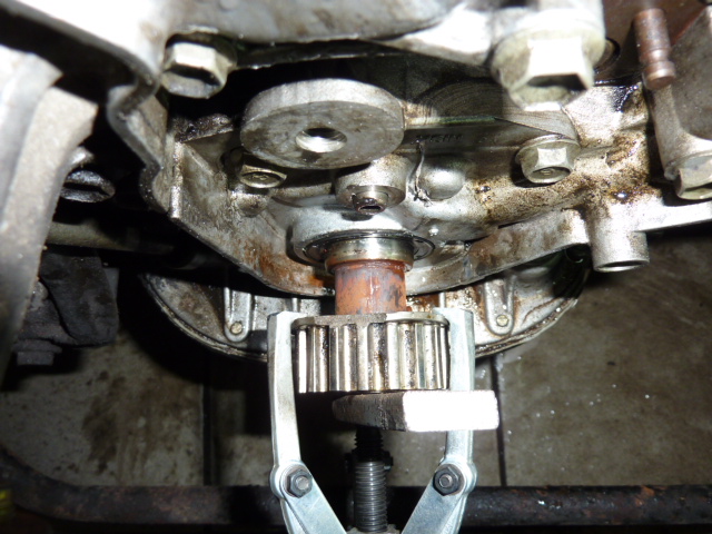

Hello,
I have to replace the crankshaft oil seal on the timing belt side.
All is removed except the timing belt pulley (not the one for the alternator belt). It just refuses to come off.
If I'm correct it should just slide off right?
I emptied almost one full can of WD40 on it but still it doesn't move at all.
Do I miss something here?
What supsosed to be a 2hrs job last already 2 days now and I want to register the car ASAP Sad
Any advise? Thanks.

Here are a few tips...
http://www.toymods.org.au/forums/showthread.php?t=28800

recently I had one so bad that I had to cut it length wise, almost all the way down to the crank with a Dremel, and then I had to split it to get it off Angry

I drilled the shit out of it, then hammered it till it fall into two pieces Big Grin Big Grin

hmm.. doesn't look promising... Evil
First I will try the 3 arm puller than the hammering and cutting...

VICTORY Thumbs up! Thumbs up!
Finally heating, and the 3-arm pulley did the trick plus additional hammering and swearing :wink:

Nomuken Wrote:Hehe
I removed one yesterday, it came off by hand. No tools needed
when the crankshaft is mint yes you don't need any tool, but after 20years in wet conditions it's totally different Tongue
